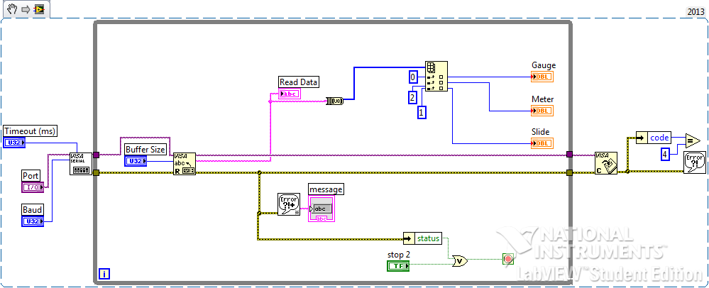

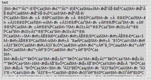

I'm using XBee to communicate with Sparkfun Sensor Stick. I want to display the data on labview. However, it currently looks like this.
How do I convert it into an array of numbers so that I can display them on indicators?
I used String to Byte Array, but it does not work.

please switch the string display to "HEX display".
Then read the manual for your SensorStick. It should contain a paragraph on the formatting of those data. You NEED TO KNOW the data format before you can convert those data!
Converting string to byte array may be a starting point, but probably you also need to use some typecast here…
Btw. downscaling the snippet graphics seems to remove the embedded LabVIEW code. Either switch off scaling of the snippet or attach the real VI (with some typical data set to default for your "Read Data" string)!

Oh! I've attached the VI.

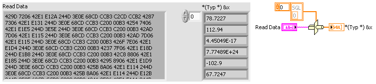

Do you expect numbers like these:check.png?
Atleast the first two appear reasonable...
