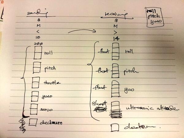

Hi! The program sends and recieves like this. It sends out 2 bytes of roll, pitch, throttle, yaw and servo.
and then it recieves a reply of roll, pitch, yaw in 4byte float and ultrasonic (altitude) in short.

OK, that is very helpful.  To interpret the received data, you can, for each value, take an array subset of the right size ( two or four bytes) and then do a type conversion on it.  You'll have to see if the numbers come out right and possibly adjust the byte order; your scanned page doesn't mention that.
I'm supposing that you know what $ M > and 14 are so you can figure out the offests.  Are these bytes?
To extract a subarray and type convert, see here.
Batya

Hi Batya,
"$M>" is clearly visible in the attachments of the first message, so here ASCII is meant. "14" seems to correspond to an U8 and could denote the number of bytes in that µC message (3 SGL + 1 U16)…
See my message #5 and the string in hex display. Here you will find the corresponding pattern "244D 3E0E"…
