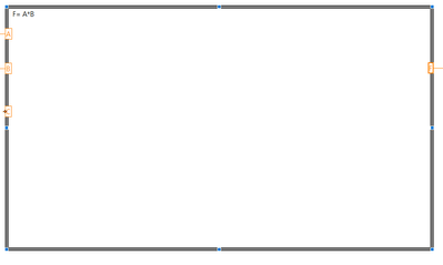

I hope this is in the right place. I'm a student that is bad at math and trying to make a simulator in Labview.
This is what i'm trying to put into a  formula node , First part is fine ,but how do i input the part below inn, how does that look in labview?
I'm making a simple heat exchanger simulation so this is change in temperature over time of the pipe inside of the heat exchanger.
This is how fare i got.
Thank you so much in advance.

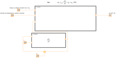

I do like the formula node, and i can't have loops becouse there a lot of formulas going into each other , I don't mean to ask for help and then disagree with the answer i'm just not sure how i'd do it with out the use of formula node,
This is my solution , how fare off am i ?

This seems to be a subVI, so most likely you need an uninitialized shift register and do special treatment on first call. Tr needs to be an input and you need to calculate dTr based on current and previous value. You only initialize the feedback node once and after that, the Tr input is ignored.
Where are the other terms of your formula? Which ones are constant? Which ones can vary with each call?
Can you tell us a little bit more about your entire project. What happens in the toplevel VI and how are you calling this? Attach that too!
Don't label a control "t" if you use it as "dt". Big difference!
This is not a solution, so you are 100% off. I strongly recommend to start with the learning resources listed at the top of the forum. Since you love formula nodes so much, it probably means that you are a text programmer. Forget all that!
In your first post you admitted that you are bad at math, so you need to sort this out first. For example notice the dot over the mr? That typically also means that it is a derivate with time. Right?
Is "t" the same as "tau", i.e. are both just "time"?
You need to fully figure out the math first! After that, implementing it in code should be trivial, independent of graphical code, text code, formula node, paper&pencil pseudocode, or whatever.
Make a list:
  • What are all the inputs to the calculation?
  • What is the output?
  • What are the initial conditions?
  • Over what time range should the calculation be carried out? (I assume you want an output vs time., i.e. an array of values)
  • Now make controls for all the inputs and label them as in the formula (long foreign language labels that nobody understands just confuse the relation between inputs and the actual formula as written!). You can use the legend for the verbal description. Do you know how to do that?
See how far you get!
