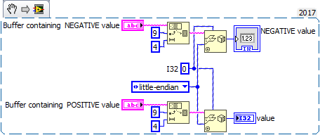

Thanks for all your answers.
I understand that my question was ambiguous so I have attached a simplified version of my VI to show what is really happening.
Top part : working ok since my value is positive
Low part : not working well because I need to make a "special" treatment as it is a negative value
I hope this made things a bit more clear.

You cant have a Negative number in a U32 indicator.  change it to I32

Hi User,
why don't you follow those suggestions about UnflattenFromString?

GerdW,
Had to run some tests to confirm...Thanks for your answer it works pefectely !
