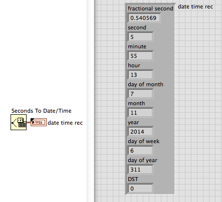

An approach that does not generate any ambiguity in transfering date/time information between (possibly) incompatible systems is to use Seconds to Date/Time and pass the elements of the cluster as text. You then parse the data and build a timestamp in the other language. It is a little more work but gives you complete control.
Lynn

That is actually a great solution, Lynn, but which will consume more bandwidth.  My guess is this solution.  Ideally, I transfer an 8 byte array representing the seconds.  If I transmit the seconds as a string, I will likely take 12 bytes.  If I transfer the stamp as something like 2014117130623.25 I am now at 16 bytes.  This doesn't seem like a huge deal, but I am trying to minimize my line usage as I am pushing a lot of data over the network connection.
Cheers, Matt
