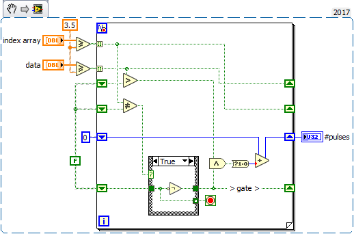

Hi guy,
I told you to use just one loop:
- detect pulses on your data array
- detect both edges on your index array
- generate a GATE from your index array pulses
- use this GATE to limit pulse count of the data array
Message 4 of 11
(6,259 Views)

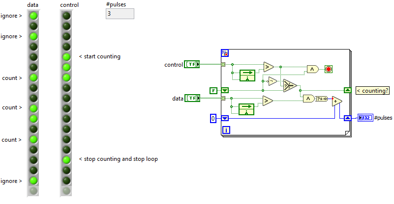

Here is a simple example using booleans. You can easily convert your analog data using Gerds method, of course.
This counts FALSE>TRUE transitions in "data" array between the first and second FALSE>TRUE transition in the "control" array. See if it makes sense.
Message 6 of 11
