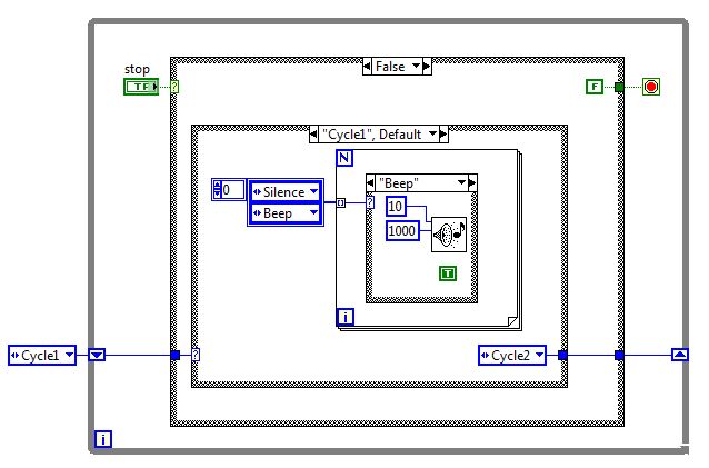

I have created a rough program based on your cycles. The below screenshot is what i can think of based on your requirements. Presuming that you have read about the state machines from the link I have provided, I'll explain the code
Basically, I have created 3 states, cycle 1 (3s silence, 1s beep), cycle 2 (2s silence, 1s beep) and cycle 3 (5s silence, 1s beep). First and foremost, you'll need to create a basic state machine structure which consists of a enum (with the state names - http://labviewwiki.org/Enumerated_type), while loop, shift registers (which passes the value from the current iteration to the next) and case structure (each with their own state).
As you can see, I have a main case structure which controls if the loop operation and within it is the nested case structure which is the state machine itself. For each case, I have an array of enums (which I have specified the names to be Silence and Beep) and a for loop which contains the case structure which does both silence and beep.
As you noticed that the for loop has a indexing tunnel. This allows the for loop to run 2 iterations. On the first iteration, the 1st index array: Silence will be as an input for the case structure and executes Silence case state. On the second iteration, the second index array: Beep will execute the Beep case state.

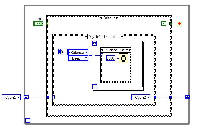

The below is the silence state for the 1st for loop iteration:
The below is the beep state for the 2nd for loop iteration:
For Silence, I have used wait(ms) to provide the pause before it goes to the next state "beep".

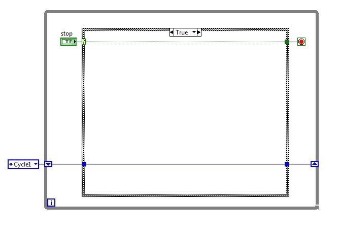

The whole operation will basically repeats from Cycle1 -> Cycle2 -> Cycle3 until you hit the stop button. If you hit the stop button, the main case structure will be as below:
Which should stop the while loop.
