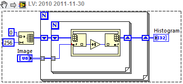

This is the simplest way to obtain a histogram.  Is it fast enough?
That will give a 256-bin histogram, but I iust noticed that you want 100 bins for some reason.  The easiest way to do that is to scale your image from 0-255 to 0-99 (multiply by 99/255) and do the same thing, something like this:

Thanks for the suggestion GregS.  However the array function that you have in the inner for loop, where did you find this?  This is something I have not discovered yet in labview
(4,110 Views)
That's the In Place Element Structure, which ensures that the array is not copied when it is used.  You can find it in the Structures palette since LabVIEW 2009 I think.  Or you can effectively replace it with the pair of functions Array Index and Array Replace - the IPES is just a little cleaner!
