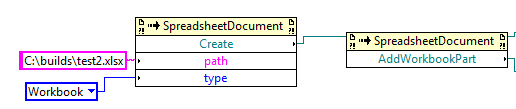

I am stuck at the part of adding sheets to the workbook.  I cannot get Labview to pull up the Method of AddNewPart.  I checked the Open XML SDK with ILSpy to see what may be unique about this method as I can see all the other methods, but not AddNewPart.  I see in ILSpy that AddNewPart is a virtual method.  Is this why I can't see it in Labview and if so, is there a way around this?
I have it working where it creates the file and adds the WorkBookPart, but the file isn't quite valid yet until I can get past the next hurdle (the AddNewPart method).  For example, this...
Thanks!

It looks like you'll need to instantiate a workbookpart object, much like you did to get a spreadsheet object, to get at that function.  AddNewPart() is a function of the WorkbookPart object and you haven't created one of those yet.

LabVIEW doesn't support creating new generic types from the generic base type, which is what your code sample does:
WorksheetPart worksheetPart = workbookpart.AddNewPart<WorksheetPart>();
See this: https://knowledge.ni.com/KnowledgeArticleDetails?id=kA00Z000000P8iWSAS&l=en-US
To get around this the best way is to create a custom assembly (with the steps you have listed above) and then call this in LabVIEW.

Yes, you need to compile a new assembly. You could use Visual Studio or a number of tools to do so. I don't know much about the Open XML SDK but I'm guessing that there might be other generic classes involved to do what you are trying to accomplish so it is possible that the problem might not end there. Any time that you see a "new" instantiation and the angle brackets "<" or ">" around the type it indicates the creation fo a new type from a generic template, which is what you cannot do in LabVIEW. Without the experience this would be challenging to do.
My advice is to ask a colleague that has C# or VB.NET experience to roll an assembly together that does the sequence of events you have right now and work from there.
Or use the Reporting functions in LabVIEW to export data to Excel (see about half-way down http://www.ni.com/newsletter/51339/en/)
