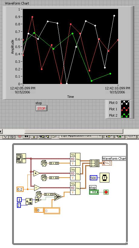

If you use a Wave From data type, re-sampling is not required.
When using a WF datatype the chart (graph) will pick-up the X value from the t0 of the waveform.
The trick is to just build an array of the single update value and make sure the t0 value is correct.
Re-create this example
and try it for yourself.
Ben
Note: make sure the data you pass is consistant with the data already displayed. If you post a t0 value that is older than what is already displayed, the chart will clear the display and start over.
Message Edited by Ben on 09-15-2006 11:49 AM
