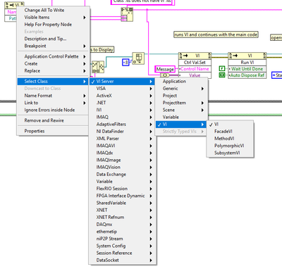

Got leads for Monday, I found this page which has a bunch of info for vi server properties and methods not supported in LV RTE.
Wouldn't you know it, VI Path and VI Name are two properties that can't be used under certain conditions.
I am not sure if my code does go through the StaticViReference Properties or not, I'm assuming yes based on the image below

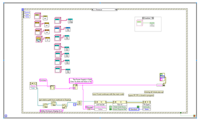

Edit: Looks like I dont have leads, I went around troubleshooting in a different way and included the code that I thought was bad into my troubleshooting EXE (below) and it runs fine on the deployed PC.  Hindsight says I should have done this earlier.

As for the bad OO design, it stemmed from my misunderstanding of how the factory pattern is supposed to be initialized and I broke OO philosophy.  When I initialized the PS 2-0 child, I dropped all child classes into a case structure that was selected by a type deff enum.  This then forced the PS 2-0 Class to have all children associated with it to be included in the executable and since the CLI dll would cause a broken run arrow, any child PS 2-0 class I would run made the executable fail to run.  To counter this, I am now using relative pathing to path to the desired child class then using the "get default class object" vi combined with a "to more specific" VI to load the proper PS 2-0 child.  From there, I removed the PS 2-0 child that is associated with the SNDCSDLM.dll from the always include section of my executable and now my code is able to run.
