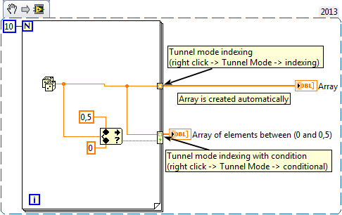

 Hi!
See the following example to understand how you can create an array in For Loop 🙂
In your case you can also uce Conditional terminal to create an array only when then numbers are within range. It makes the code much cleaner than case structures 🙂
Hope this helps, if not, let me know so I can help you!
Marcin

@mtwar
Hi! Thanks for your input, it works very well with finding an Array of numbers within that range. However, can I make it such that a second array is displayed which has the rest of the numbers, rather than displaying all of the numbers in that set?
Thanks!
(6,823 Views)
You can add one more conditional indexing and build array when the condition is false or true as required.
uday
(6,819 Views)
@udka
I see. I can just at a 'Not' and it will do the false ones. Thanks a lot guys!!
