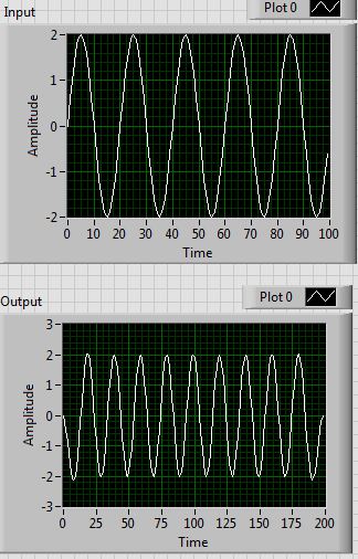

The simulated signal is set to f=50, Amp=2, Samples per sec=1000, and number of samples=100.  Here is the input and output graphed.Graphs.JPG

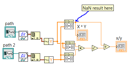

I went ahead and just built out the cross correlation formula instead of using the VI.  I also am using two .wav files and I got my expected result of 1 when using the same file.  However when I tried to use two different .wav files, I get an unexpected problem when doing the dot product of the two signals (ie A dot B).  I know this is a Not a Number result from doing a calulation with part of the array not being initialised but I am unsure how to correct it.
Message 8 of 13
(6,368 Views)
I don't know what's going wrong with your vi, perhaps the arrays are of different lengths? (check the error output of the dot product vi, always check errors, especially if you are getting erroneous results)

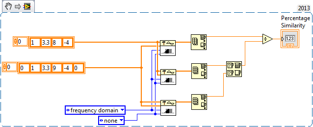

Anyways, cross correlation is NOT just a dot product. It is a dot product at every possible offset of the two signals (pretty much), which is why it has an array as an output (one output for each offset). (I guess it would be more appropriate to say that cross correlation is a function having a parameter of offset and returning the dot product with the signals offset. However most cross-correlation functions you are bound to come accross give the cross-correlation for each offset)
Here, take a look at the implementation of the suggestion I gave in my previous post.

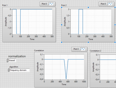

I guess i have a similar problem in understanding normalized Xcorr. I always thought, that if a signal A is equal a signal B (A=B), you get a peak of 1 at the position where the signal A fits best to the signal B. Is that correct?
I dont get a coeff 1 in any kind of normalisation. see images tried with some generated pulse pattern. same signal (neg), same array length (sampling)
I want to use that feature for a kind of "pattern recognition". So I thought, if I just use a smaller part of signal A and corellate it with A itself, I should get a position with the highest correlation peak where this small part best fits to the rest of A? Is that correct too, or am I missing something?
cause when i try it it doesn't seem to work at all. I even tried  kuind of zeropadding to make the signals to same length. im confused..
Here the test images: left up: base signal (A) the lines mark the part of the part i use as pattern (up right / part of A) to detect.. but i cant see any peak in the correlation (down left).. I just see the same base signal... smoothed. (image left down) I then tried to split the base signal to loop the correlation with the pattern signal at same array length (down right). but the result seems similar.
I got stuck with this. 😐 maybe someone can help?
Thanks in advance!!
Best Gybrush
