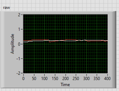

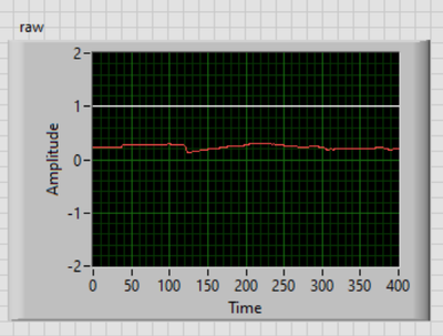

this is signal 2 (red) compared to arrays of 1 (white):
this is  signal 2(red)  compared to signal 1 (white):

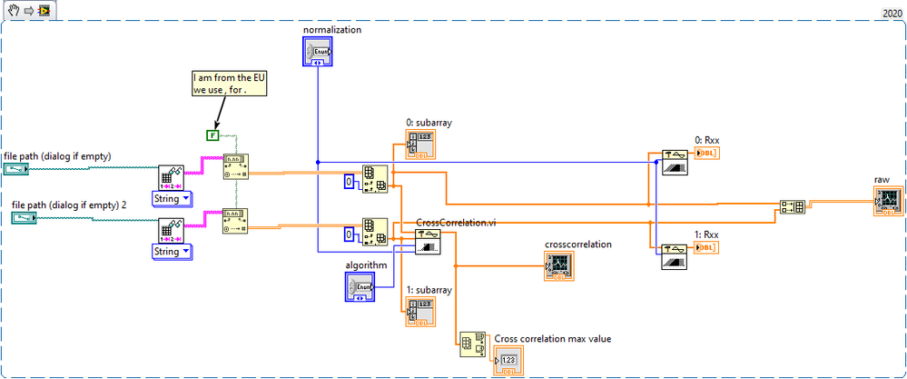

as far as i am concerned, crosscorrelation vi works as expected:

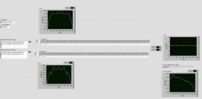

The question I have left is why the cross correlation code is not returning a max value of 1 when cross correlating the signal with itself?
For a little more context - I added two more .csv files which represent the mean of 15 trials each. If I use the correlation coefficient VI, correlation between real data 3.csv & real data 4.csv is 0.949. And perhaps I am overthinking this, and the correlation coefficient VI is sufficient since I know there is no lag between the signals.
