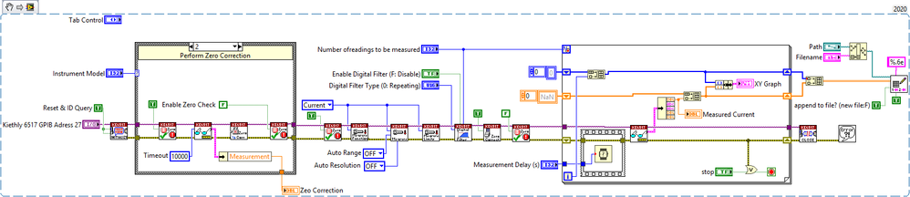

Something like this should do..

From where did you get this Vi example?
Did you modify it by yourself?
Message 4 of 9
(4,113 Views)
Yes
i have modified it.
Message 5 of 9
(4,109 Views)
This example better to use as it is. It's intended for completing simple tasks, and you should use it without modifying.

Hi
Thanks for reply. Could you please send me this VI compatible with 2017. I am using 2017 and this in in higher version.
Message 7 of 9
(4,084 Views)
Accepted by topic author Aashi
Here you go.  Let me know how it works for you, I have the 6517a.
