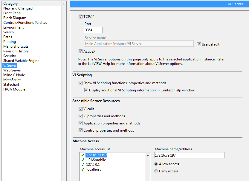

I have issues using the VIPM (not able to connect to LV). I tried a lot of stuff to be able to use VIPM again (it was working previously, maybe some windows update changed anything). NOTE: I do not use windows firewall! The other firewall was not updated since the last time VIPM was working.

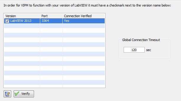

I only have LabVIEW 2013 f2 installed, but Run Time Engines from 2011 up to 2014. I think that is not the problem.
I checked the ports in the VIPM and it is the same as the one in LabVIEW configured.
Interesting is, that in VIPM the connection status (the row next to the Port number) is Yes, but if I click verify, it doesnt work, same error again when it tries to connect to LabVIEW.

What happens when you click the 'Verify' button?
Does it launch LabVIEW? If yes, then it's probably a VI Server configuration issue (port in use by another application or LabVIEW instance e.g. a project or the environment settings) or if it takes longer than 120s to show the splash screen you might need to increase the time-out. I've increased mine to 300.
If it doesn't launch LabVIEW...I'm not sure. Contact JKI or read through the troubleshooting page that was linked earlier.

Hey guys,
I was now able to "verify" it and I guess I will now be able to install via VIPM.
What I was changing:
- 300 seconds timeout (although it is definitly faster so I dont think this was the solver)
- adding an asterix *  under machine access. This was actually my first change and I would have sworn, that it is already in the allowed list, but I checked my picture from this thread and it wasnt there. Maybe I entered but closed the options window in LabVIEW the wrong way 🙂 So this is my favourite in the solution.
- changing the port on VIPM side and VI server side to 3367
