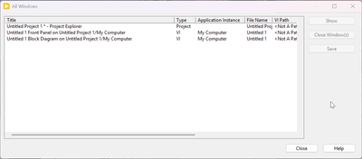

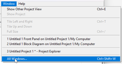

I've been looking through right-click framework and project providers. Can either one of these allow you to customize the "All Windows" dialog located under the Windows pull-down?

That is not a VI-based dialog, so there is currently no way to customize it.

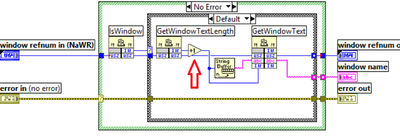

@Zou, I couldn't get your utility to work. All of the VIs listed in the Title column on your front panel have the last letter truncated, which was apparently causing problems. I added the increment function in the Get Window Name.vi as indicated by the red arrow in the screen snapshot below. That seemed to fix it.

I did find out the bug.  I meant to include this VI in my post, but I picked a wrong VI.

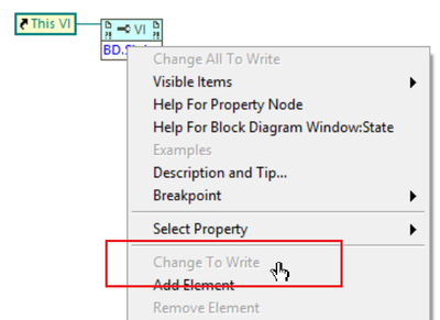

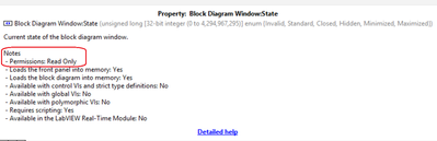

It would have made a great addition to the All Windows dialog but apparently it's not customizable. Also, I was hoping to achieve it with only VI scripting but the Block Diagram.State property is read only ☹️. Hopefully @Darren  is still listening 🙂
