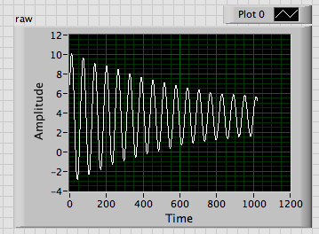

One thing which is immediately obvious is that the model does not match the data! You need at least one additional parameter. When I plot your data I see a significant offset from the X-axis and your model equation does not have any such offset.
Note that the mean value appears to be approaching 3.5 to 4.0, not zero.
One thing I learned from altenbach, who is probably the most expert participant on the Forums on curve fitting, is to always plot the data so you can see what is going on.
Lynn
Message 6 of 15
(5,178 Views)
It fits quite well with an appropriate model.
I prefer to use the Nonlinear Curve Fit.vi rather than the Express VI. It requires a bit of extra work but usually gives good results.
Lynn
Message 7 of 15
(5,171 Views)
Here is a version with the model equation in the Express VI fixed.
Lynn
