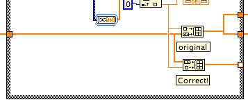

Ah! I messed it up for you. Sorry. By prepending the new data at Build Array, it reverses the array. The image below shows the correct way.
Other questions: It appears that you are reading 10 data points on each iteration of the loop but only appending one to the array. Why are you throwing away the other 9 points? It also appears that you need to read the DAQ Assistant and process the data 50 times per second to keep up. As the array grows larger, it will become more difficult to do that. I suggest reading larger chunks less often and looking at managing the array size appropriately.
