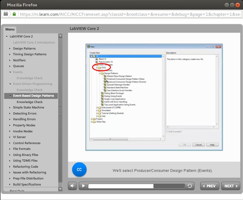

lookinng through LabView core 2 I've noticed DAQ VI templates (please, see the snapshot below), that aren't present in my installation.
How can I get them ? Or they are merely custom templates ?

EDIT: I've just seen that in my 2015 installation, i don't have these DAQ templates either (though i have DAQmx availble). I find it possible that with newer versions of LV/DAQmx these templates were removed. There are (with 2015 and i think already with 2014) some DAQmx based template PROJECT available though....

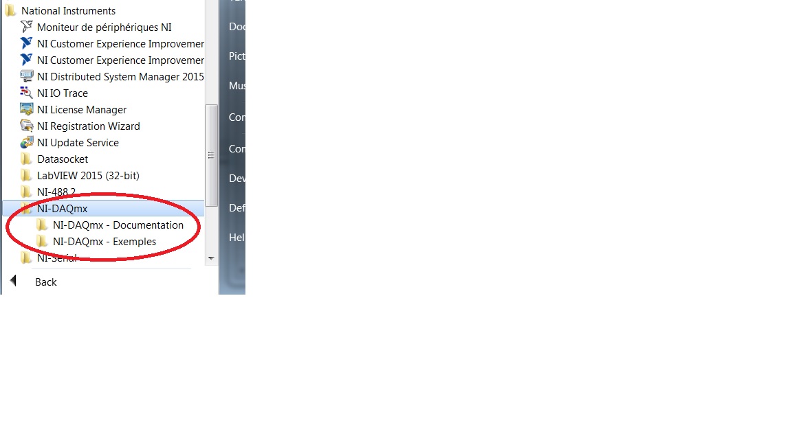

Yes, here is snapshot of Start/LabView folder:
