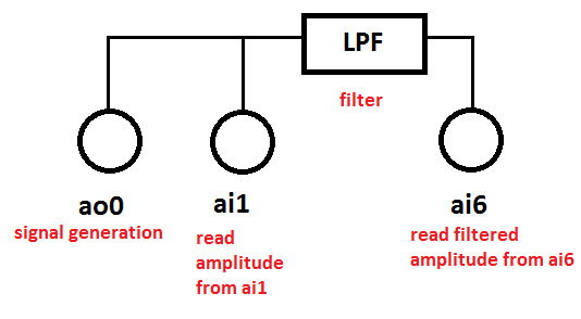

I want to create the Low Pass Filter Tester with TestStand. I want to generate sine wave with frequency form 1 to 1k Hz and read amplitude before and after the filter. First of all I have to ensure synchronisation between DAQ read and DAQ write[ http://i79.photobucket.com/albums/j122/thor_tory/1_zpsab4a4c00.png~original ]. I already used a bit modified examplary sine wave generator to analog output VI and read from analog input VI. I put them as subVIs into one VI and then called it in TestStand although the read apmlitude was in many cases not even close to the generated amplitude (like the read was performed too soon). I put all subvis one by one, I also tried flat sequence structure but it was not ok because it stopped in first stage while generating sine wave.

What I want to do is to change the input frequency of the sine wave, that will be done in TestStand sequence and passed as a parameter to the VI. I want to be certain that for each given frequency I will obtain true value of the amplitude of the signal. So I'll be able to gather the data before and after the filter for frequency in range 1 Hz - 1 kHz with step 10 Hz and plot its frequency response.

I want to pass only frequency of the signal to be generated. After the vi is executed I want the amplitude before and after the filter to be sent to testand and in testand I will increase the value containing frequency and call vi again up to the set max frequency eg. 1kHz
