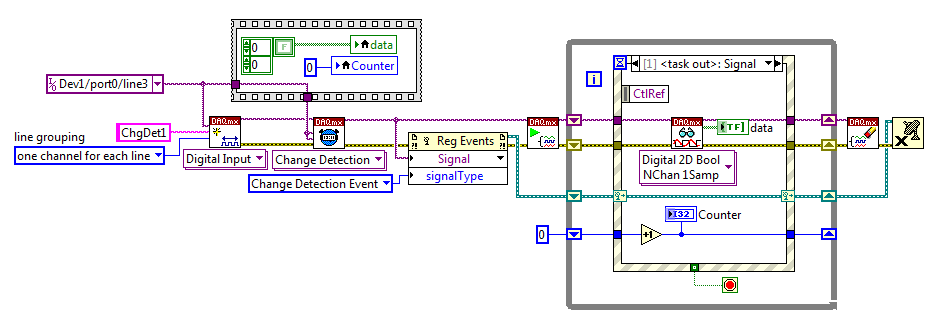

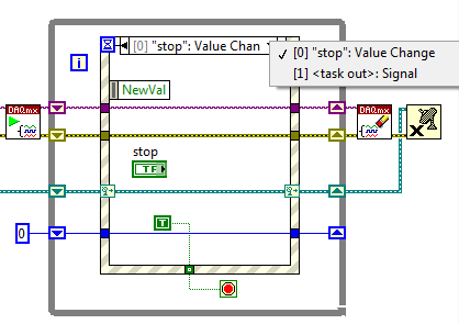

I am trying to use DAQmx to do change detection on some digital lines. I think I have setup everything according to this article, however I am consistently getting the error "Error 1 occurred at Unregister For Events in Test Change Detection - Unregister Error.vi". When I change the structure to register some other event, not involving DAQmx but using the same structure, I don't get this error.
I will need to implement this on a code that runs for a very long time and according to the above article:
"Use the Unregister For Events function and the Destroy User Event function to release the associated events and the user event reference. LabVIEW unregisters all events and destroys existing user events automatically when the top-level VI finishes running. However, to conserve memory resources, National Instruments recommends that you unregister and destroy user events explicitly, especially in an application that runs for a long period of time."
Here are some screenshots of my BD, as well as the .vi. Note that the actual change detection is working well, it's just after I click "stop" that I get the error generated by the "unregister for events.vi"

You need to unregister for the event before clearing the DAQmx task.
Clearing the task implicitly unregisters the events.  If you clear the task, rather than simply unreserve it, the event is already unregistered and you do not need both nodes.
Or simply put, the event is part of the task.  no task, no event and LabVIEW cleans up the registrations for the non-existant event.  Other events that arenot "Owned" by similar I/O Sessions must use the unregister (Like User Events)

A number of posts have been coming up recently about this in the DAQ forums.  It appears that in a fairly recent version of LabVIEW (LV 2013 according to this post) some changes were made regarding the error reporting for unregistering events.
If you want to explicitly unregister your DAQmx Events, you'll need to first stop the task, then unregister the event, then clear the task as shown here.
In older versions of LV the unregister did not return these errors (for example, on my system using LV 2011 and DAQmx 9.7.5).  In more recent versions, it appears errors are returned by the unregister in the following cases:
Attempting to unregister an event associated with a task that is still running:  The unregister will return an error informing the user that it isn't possible to unregister the task while it is running.  According to comments in the first post I linked, it sounds like in older versions of LabVIEW the unregister would silently fail--the error isn't new, but LabVIEW is now correctly reporting it.
Attempting to unregister an event when the task has already been cleared:  The unregister will return an error consistent with trying to unregister an event that is not registered in the first place (i.e. because DAQmx Clear Task has already unregistered it for you).  I'm assuming that the reason that this error is now showing up is due to the fix for the error reporting in the Unregister For Events call, but then again I'm not sure if DAQmx Clear Task has always unregistered the events implicitly or not...
