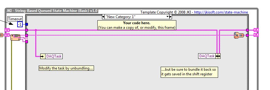

First of all, i would say that you really should take a blank template of the JKI state machine and run it in "Highlight Execution" mode to see what is happening.  The fact that you put a sequence structure around the case structure tells me that you don't have a full understanding of it yet.
I can also see you don't fully understand the state machine because of the overuse of local variables. Look in the Data:Initialize case and make use of the bundle function there to add other datatypes that you might use throughout the program.  For instance, you could take a task constant, give it a name, bundle it into the shift register, and it will store your task.  It's very easy to unbundle it where needed...no need for a local variable.
Edit: Just realized that a DAQmx task doesn't need to be rebundled in most cases, since it is basically just a string.  But the comment does apply to other datatypes that need to be saved for use elsewhere.
