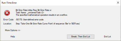

This strategy seems to work up to 245 760 kS per channel. But if i increase that number, i then get the following error on the output of the DAQmx Read VI:

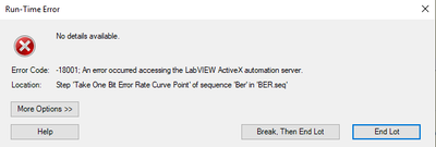

The only mathematical operation i can think of  is the conversion from raw data format to DBL which is internally done by the logging mechanism. So i tried to change from analog -> multiple channels -> 2D DBL to Raw I32 datatype.
But i get another error :

The problem seems to be that i set a number of samples per channel to high. For some reason, there must be an internal computation that reaches I32 limit, my number of samples per channel was 399 360 000. Multiplied by the number of channels (8), it overflows for a I32, that's my guess.

I confirm the problem appears when the number of sample per channels*number of channels is higher than the I32 max positive value.

Concerning the error of my initial post, the error is really outputed on daqmx read output error cluster. I tried to change the samples per channels for the task and on the input of the daqmx read vi and the error appears just after I32 max positive value/number of channels is reached.

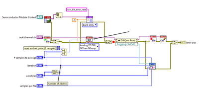

@nlefoulon wrote:
Thanks for the tips both of you. I'm going to make few changes to my buffer size, and the number of samples per channels.
McDuff, it looks like by using daqmx logging the data is already saved in raw data.
"If you enable TDMS data logging, NI-DAQmx can directly transfer streaming data from the device buffer to the hard disk.NI-DAQmx improves performance and decreases disk space usage by writing raw data to the TDMS file and separately including scaling information for use when reading the TMDS file"
I don't know if it changes something to change the DAQmx read to unscaled data when logging is enabled as it already takes 4 bytes/sample instead of 8bytes, have you ever tried both ?

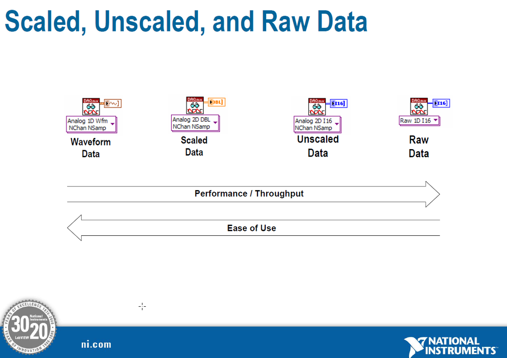

In your diagram you used the "Log and Read" mode. When it reads it converts it to double (scaled). Depending on your set up this could be okay. I typically do my scaling, any calculations, decimation in a different loop than my DAQ. That means I need to acquire the data in one loop and analyze, plot, etc in another. That is two data copies. Depending on the number of channels and sample rate, that could or may not be a problem.
mcduff
See NI diagram below
