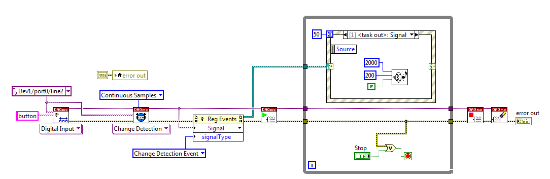

I am trying to set up a change detection on a digital input line for triggering a software event.  I am using the PCIe 6321 DAQ board.
This works well with a buffered IO line (i.e. any line of port0, see code snippet). However, since I need the buffered lines for other tasks, I would like to use one of the PFI lines (port 1 or 2).
Now, if I use for instance port1/line2, I get error -201062:  "Selected lines do not support buffered operations. Ensure only lines that support buffered operations are being used in the task. If using change detection timing, the task must be changed to non-buffered to support these lines."
So, is there a way to do the change detection on a non-buffered line?

 change detection code

No, only the non-PFI lines of port 0 are going to support change detection at a hardware level.  Otherwise, you're stuck with software polling on ports 1 or 2, with limited timing resolution and no guarantee of catching every change.
