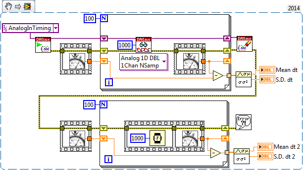

Well, that's embarassing.  I just ran the following code, with a USB-6009 set for 1000 Samples at 1KHz as my DAQ device and using LabVIEW's High Resolution Timer (which reads, I believe, the CPU's System Clock) for timing info.  I expected the second pass that used LabVIEW's Wait function running off Window's millisecond timer (which has to contend with whatever Windows might be doing to "steal cycles" to do less well.  Here the code:
and here are the results (expressed as mean ± S.D.):  USB-6009, 0.999916 ± 0.000887; Windows/LabVIEW, 0.999940 ± 0.000240.  To my great surprise, (with a single test), LabVIEW's clock "won" (was closer to 1.00000 and had a smaller S.D.).
Well, what do you do if the Experiment Proves You Wrong?  Why, you do it again.  Just a second (or rather, just 200 seconds).  Nope, same general finding, 0.999921 ± 0.000818 (USB) vs 0.999948 ± 0.000243.  I'll note that my PC was relatively "idle" during this time, so the CPU wasn't doing too much multitasking (as might be the case if this was embedded in a big LabVIEW program), but still, I did expect Hardware to win ...

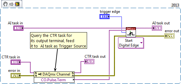

  You can query programmatically for the pulse terminal of a counter output task using a DAQmx Channel property node.  Here's a snippet.  Just save the image & drag the file into a LabVIEW block diagrom and it turns into code.   You don't have to use this as a subvi, the controls & indicators are just there to identify which task is which.
