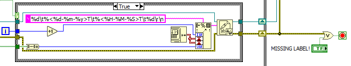

I think this solution is ok (I attach the code for reference in case, sub-vi RDI is just a Daqmx read plus some algebra).
Thanks for your support

I'd suggest trying to straighten out some wires, but otherwise that looks fine to me 🙂

Hi Davide,
@DavideB wrote:
I think this solution is ok.
Some more improvements:
  1. Replacing the ConcatString and several FormatString functions with a single FormatIntoString with a proper format string.
  2. Also note that "MISSING LABEL" at one of your controls: NEVER delete the label! (It's ok to hide it in the frontpanel.)
  3. You don't need to unbundle the Status of the error wire for an OR function…
  4. Right now you wire the error cluster through your FOR loop and also through the WriteFile function: when there is an error upstream you will not write data to your file! Maybe you need to change that error handling a little bit…

Thanks for your suggestions,
but if I unbundle the error I get an error, at least with my old version of Labview.
I understand from your previous post I should handle errors differently, but I dont know how..

Hi Davide,
Which LabVIEW version do you use?
On error handling:
When you want to save data to file even when one of your two DAQmx tasks gives an error then you should NOT wire that error cluster into the WriteFile function: when an error is present at error in it will not write any data…
