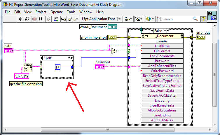

If you have all of this software, then open vi.lib\addons\_office\_wordsub.llb\Word_Save_Document.vi and make the following modification:

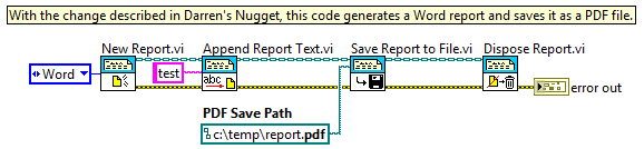

More specifically, add the ".pdf" case with a value of "17" inside. Now, if you wire the path to a PDF file to the Save Report to File.vi for a Word report, then a PDF file will be generated:
