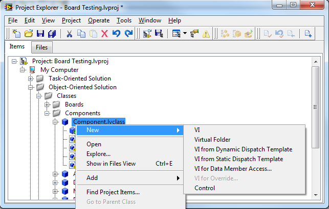

When programming with LabVIEW Classes, there are a few different kinds of new VIs you can create from the project window:
18293i0ED370838DCEAD5F
Some of these new VIs are created from templates.  And if you know where those templates are, you can modify them to your liking.  For example, if you want to remove the diagram comments, or maybe shorten the error cluster names, or even add code to the diagrams, you can do so, and those changes will manifest in all future VIs you create from these New... menu options.
New > VI from Dynamic/Static Dispatch Template
The template for these menu options is at resource\Framework\Providers\LVClassLibrary\CLSUIP_MemberTemplate.vit.  When choosing this menu option, the only real operation that occurs is that the class controls on this template are replaced, and in the case of creating a Dynamic Dispatch VI, the class terminals are set to Dynamic Dispatch.  So when modifying this template, the only real requirement is that you don't remove/rename the LV Class controls on the front panel.
New > VI for Data Member Access
This menu option brings up a wizard for creating new data member access VIs.  and there are 12 potential templates that might be instantiated, depending on if you're creating a read/write VI, whether or not you want error terminals, and what data type (scalar, 1D array element, 2D array element) you're trying to access.  The easiest way to find these templates is to search the resource\Framework\Providers\LVClassLibrary\NewAccessors folder for *.vit files...you should find 12 of them, and their locations/names indicate the situations in which they're used.  As for modifying these templates, they all include a decoration on the front panel that specifies where the new control/indicator should be dropped.  You can move this decoration (to change the drop location), but do not delete it.
