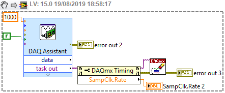

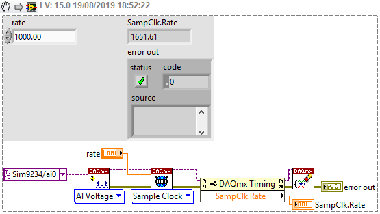

With a simulated NI-9234, it's possible to test the available sample rates.
The reason for non-continuous availability is described in the datasheet already mentioned, but you can apparently supply a different master timebase if needed.
(This is in general true, but often modules have a timebase like 100MHz, allowing more "normal" data rates to be easily achieved).
Here's the DAQmx code to check the actual sample rate. Note that to use the NI-9234 with DAQmx you'll need either a cDAQ or one of the newer cRIO-904x (but I'm guessing this is already true for you since you're using the DAQ Assist node...)
Using DAQmx rather than the DAQ Assist node can often provide you with more information, or at least, the availability to find more information.
Edit: With the DAQ Assist node, if you wire "False" to the "Stop (T)" input, and then connect the "task out" to the same DAQmx Timing and Stop/Clear Task, you can get the same information...
