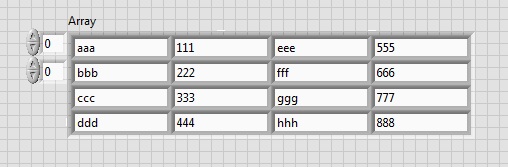

Lets say your database fetch results with this 2D array :
What do you want to insert into the ComboBox Strings and Values ?

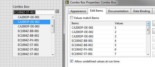

Hi Amitai,
Thanks for the reply. That was exactly what I was trying to do. I found a way to do it using a shift register (attached), yours is much simpler.
