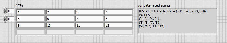

You can't insert many rows by this way (You are trying to add just one item instead of many rows.).
1st way: thy C:\Program Files (x86)\National Instruments\LabVIEW XXX\examples\database\Database Logging (parameterized).vi
2nd way: build SQL request

First, you should "try" to practice attentiveness, because you did NOT try my example, but something of your own.
INSERT INTO table_name (col1, col2, col3, col4)
VALUES ('111', '2222', '3333', '4444') ('55', '6', '7', '8') ('12', '11', '10', '9 '))
This is NOT a valid SQL query and this is NOT what I sent.
Secondly, you should try to learn SQL syntax, then half the questions will disappear.
Here is what I sent as an example.
VALUES
('111', '2222', '3333', '4444'),
('55', '6', '7', '8'),
('12', '11', '10', '9');

Now it works like that,thanks for help.
