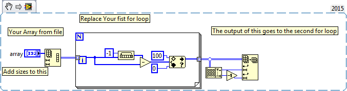

I do not know or can't figure out what you are trying to do in your second for loop. You should be able to use Array index instead of array subset to for your operations, that may help with memory usage. Try replacing the first for loop with the following and see how it works.
Cheers,
mcduff
