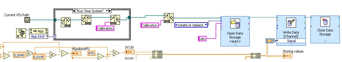

I got a problem in data storage and read. I used the combination of "Open data storage", "Write data" and "Close data storage" to store some data as an array as shown below.

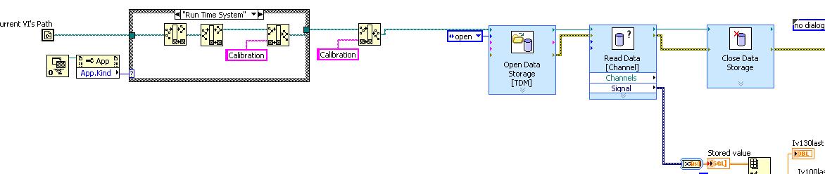

And used the inverted combination to read data as shown below:
As shown the data file is in tdm form. This works fine in my computer, both the VI and the stand alone application. However when I run the stand alone application in a target pc, the storage file can't be generated!
