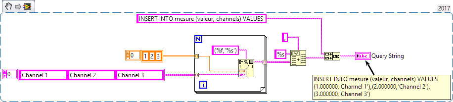

You have misunderstood what I suggested, in your for loop, you generate N queries (one for each channel). Instead of that, generate a single query with N VALUE sections, like this:
 It has the exact same structure as your existing code but does the inserts in a single query.

I'm sorry I didn't understand you at the beginnig, I tested that and I have the same string query as you showed me. But now I have an error that says that "Column count doesn't match value count at row 1". I'd like to inform you that my database table has two columns (value & channels).

It seems like the decimal separator where the problem was, I added %.; to my query and now it works.
Thank you so much for your help, I really appreciate.
