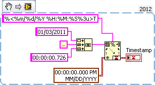

Does anyone know a quick way to convert a string array in Time format to a timestamp without having to put the whole format through a for loop (I have 1.2 million samples each time) and its taking a while. Does anyone know a quick algorithm or something similar to speed it up?
String is in the following format  00:00:00.726     and I have also have the date string available eg.   01/03/2011  but has to be a string as I am geting it from a txt file.
Any help would be appreciated.

You could read the file line by line and use the scan from sting function to convert to a timestamp.

Thank you for the quick response, what you have there is what I am already doing, I was just wandering if there was a way to convert a full array at a time?
What you are proposing still means I have to do it line by line which takes time, I have an array of 1,000,000 items and just want to avoid doing them line by line or in a single for loop etc.
Just wandering if it was possible?
