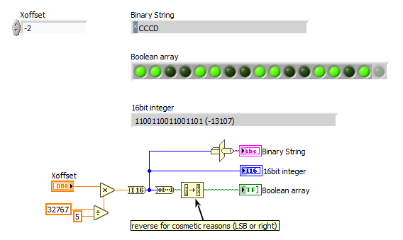

Here is a simpler version of what I did so far. The conversion here is from digital to binary, what I wish is from digital to binary two's complement.
(7,266 Views)
Accepted by topic author Giulia30
Your code makes absolutely no sense.
Maybe this can give you some ideas.
(7,253 Views)
Thank you.
