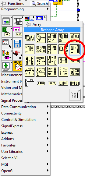

Hello Lukas,
look at "reshape array". This is what you search for.
Greets, Dave

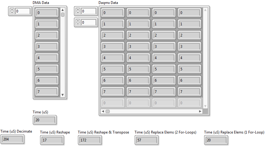

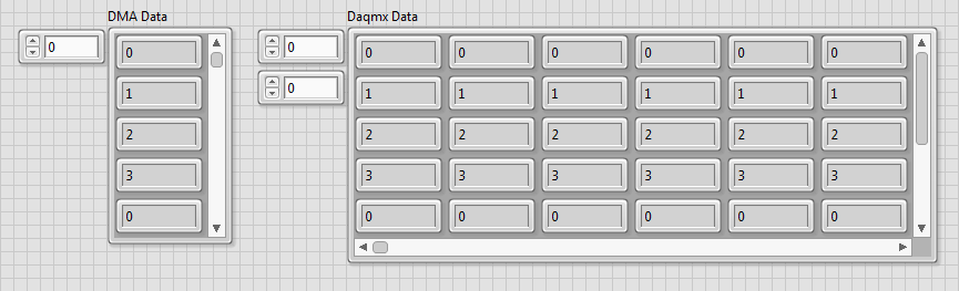

Reshape does something different though, compare the resulting arrays (decimate and build on top, reshape as in Gerds example on the bottom):
If I change the inputs for the reshape function and then transpose the resulting array I get the right result but the operation takes around 5x longer to complete than decimate and build. The reshape without transpose is faster though.
I attached a new version of the example with all three approaches in a disable structure.
 Looking at memory usage there is a buffer allocation for both the reshape and the transpose VI. I think this is because of the changing dimensions of the array although the amount of elements stays the same. Is there a better way to do this?

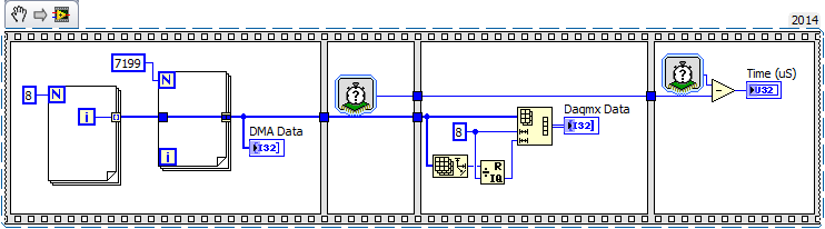

Hello Lukas,
the best is, to avoid constantly new allocated memory. My best solution is, to use "initialize array" and replace the elements. The performance results are shown in the screenshot below.
As you can see, the approach with replacing the elements in two nested for-loops is three times slower than the one-loop-approach. There you can use the autoindexing feature and the fast quotient&remainder- operation fits very well our needs.

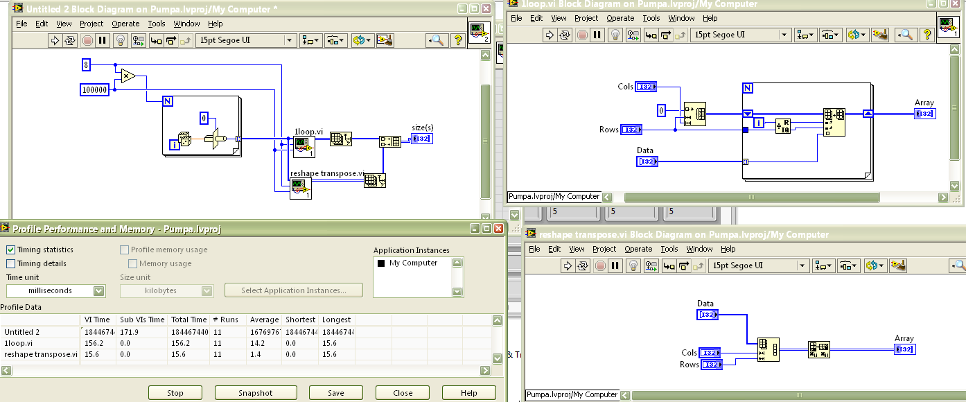

daveTW, strange benchmark results...
For me transpose and reshape is much faster. First run (memory allocation) is the same, then reshape&transpose 3-10 times faster.
LV2011, both front panels closed during test, array size was reset before test (to ensure the same starting conditions.

That's not a very good benchmark, because the reuslts seem wildly variable. I also probably would not run the two subVIs in parallel.
You can get orders of magnitude faster by disabling debugging and inlining of the subVIs . I've seen cases where reshape was 5x faster or the opposite with no real change in code. This probably needs to be investigated with more precise benchmarking code.
Message 8 of 14
(7,534 Views)
OK, the main flaw is in your loop code, spoonfeeding one element at a time and doing a Q&R so many times.
You get much faster replacing one column at a time.
With a more precise benchmark, I get the following on my laptop:
Your loop: 7ms
Reshape/transpose 3.0ms
My loop: 3.5ms                   (Edit: the original posting had a bug, reposted with correct code)
