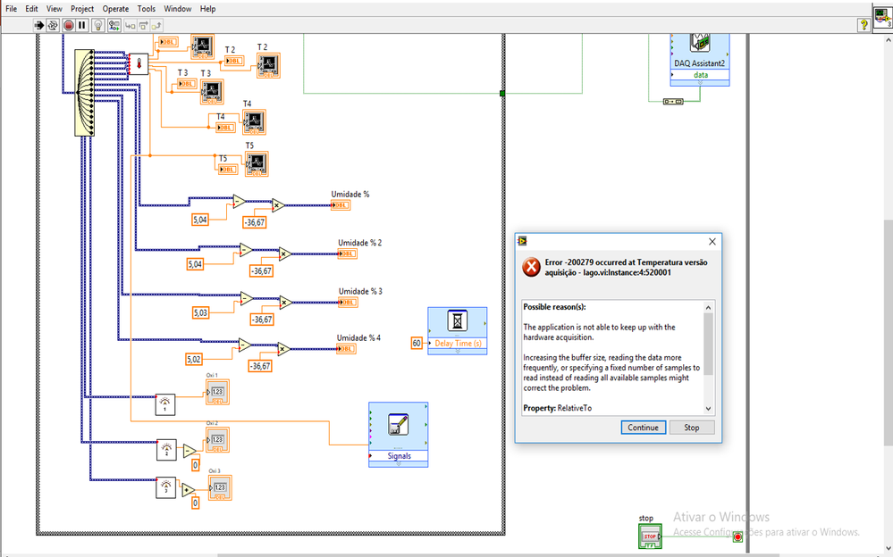

I'm trying to use Delay Time to assist in acquiring data from my program for excel, but it's giving error.

a truncated picture is not suitable to troubleshoot the problem. Attach the VIs instead.
Did you read the error description? A 60 second wait is very long.

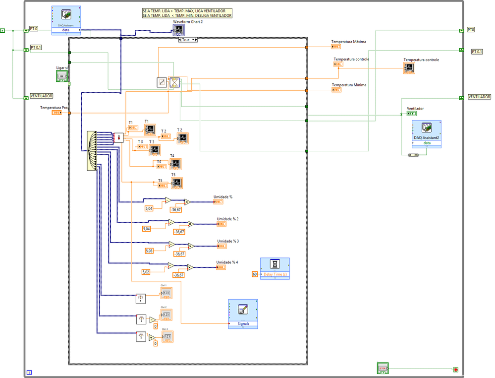

Where's the code relating to acquisition? To excel?

this was just test, I need the code running 24 hours, but that the data acquisition is every 30 minutes
Message 3 of 14

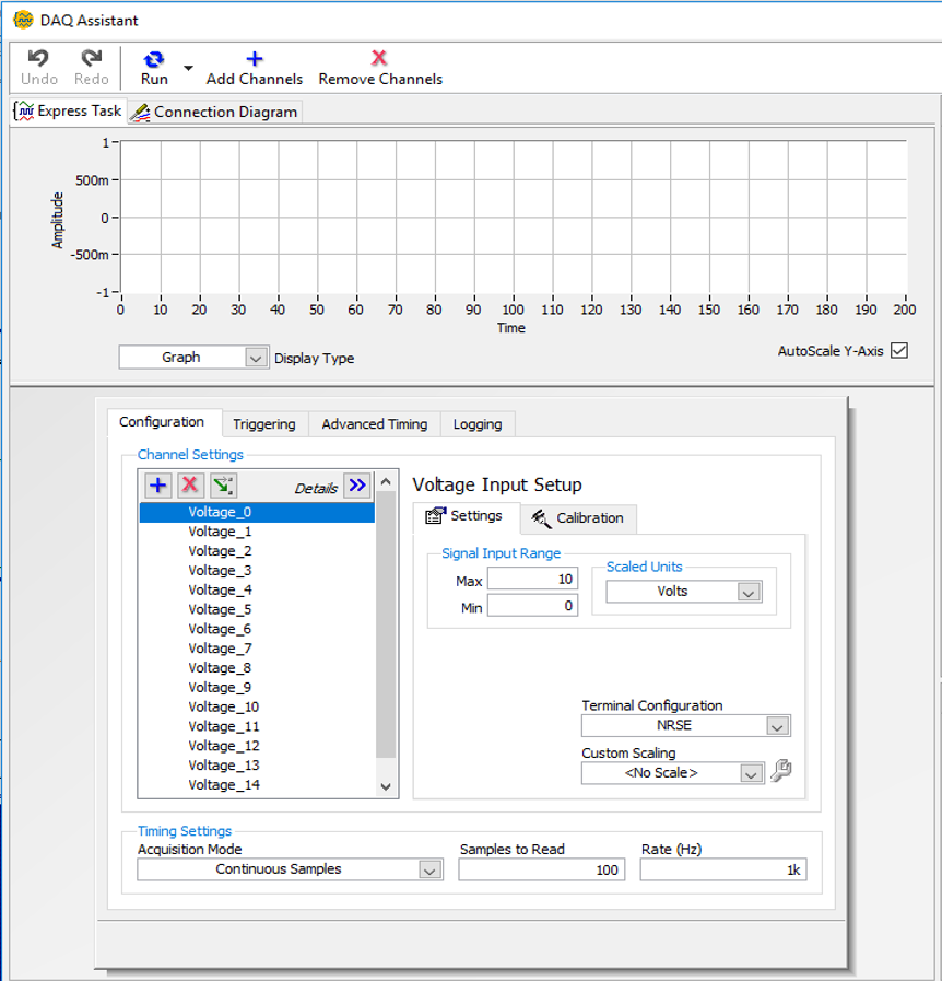

As we always say, we won't debug pictures. There is not enough information content. How is the assistant configured?

That DAQ Assistant explains it.  You are telling it to use Continuous Sampling, but you are only going to read the buffer once every minute.  You are filling up your DAQ buffer.
Try using N samples mode.  Or don't delay your loop, just read the data every iteration,  but use an Elapsed time Express VI to determine when 60 seconds are up and use that to control when the Write to File Express VI executes.

Yes, I tried to use other moder acquisition, but it also hangs. I'll try VI Time Lapse to determine the acquisition, thank you.
