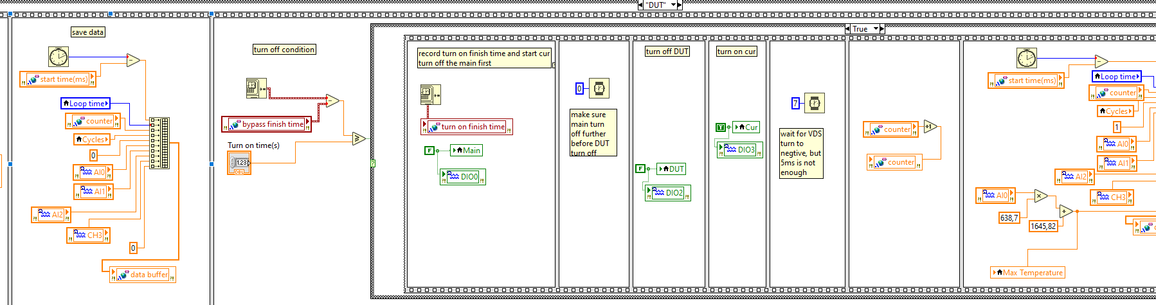

In the below figure, on the extreme left, I am writing data at regular sampling of 30 msec using timed loop. When the turn-off condition is met, we do the switching of the MOSFETs and then again write the data (extreme right) at that operating state (MOSFET highest junction temperature). This data is stored when turn-OFF condition is met.

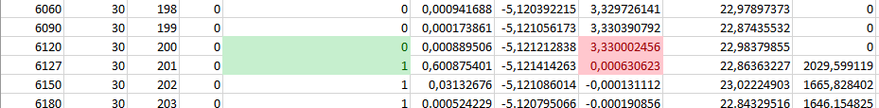

In the below figure, the data in green shows that MOSFET is commanded to switch from ON to OFF. The data in red shows the ouput voltage from NI-9402. This is without having any delay in between the time when the command is given and when the data is read. Column 1 shows the sampling time in milli-second.
The below data is when delay of 6 millisecond is introduced and it didn't worked this time as well. The data in red still don't changed to zero (NI-9402 low state)
The below data is when delay of 7 millisecond is introduced and it worked.

Hi Bhanu,
@okidoki21 wrote:
I am using NI-9402 with cRIO NI-9022 to switch the MOSFETs. I am performing the power cycling test, where the junction temperature of the MOSFET is cycled in between given temperature. During the test, I store data in the TDMS file. I have implemented the sampling time-period of 30 msec by using the timed-loop. In order to capture the maximum temperature, I have used additional sampling when the condition of maximum temperature is met. Therefore, there will be additional sampling (in 1 cycle) in between 2 regular 30 msec sampling.
However, I have noticed that I have a big delay time (around 7 msec) from the time when LabView commands to turn OFF MOSFET to the time output of NI-9402 turns low.
IMHO your VI lacks any proper design/algorithm…
  • Placing a timed loop set to iterate in 30ms does not ensure this iteration time when you place large sequence structures inside, with lots of ScanEngine IO nodes and also lots of SharedVariable accesses! Why do you need to access the same IO nodes multple times within one iteration of your loop?
  • Why do you need so many local variables? (Use wires…)
  • Why do you need to write to a shared variable in one frame and read from it in the next frame? Why don't you use a wire in such places???
  • Why do you write to indicator terminals in one frame and read from their locals in the next frame? Why don't you use wires in such places, too???
  • Why do you write to a terminal in one case of a case structure and to a local of that element in the other case? When you want to write to that terminal in both cases then that terminal belongs AFTER the case structure!
  • Why don't you implement a (proper) state machine with some decent data handling using atleast one shift register?
  • Why don't you use subVIs to make your main VI more readable?
  • Why do you place charts inside a timed loop? (This is a no-go.)
  • Why do you use charts on a REALTIME target at all? Your "legacy" cRIO controller doesn't provide any display connector and so is NOT capable to display an UI!!!
When you want to use a Realtime target for realtime applications then you need to write your program in a realtime-compatible fashion!
My recommendation:
  • Learn LabVIEW basics and start to "THINK DATAFLOW!".
  • Then learn LabVIEW for realtime target basics and apply them to your project!
NI provides training and manuals for both recommendations…
