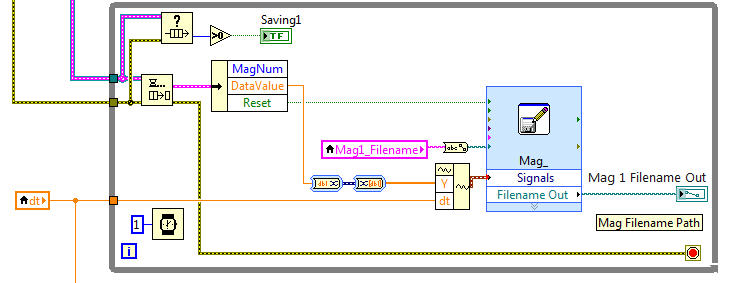

I am writing data to a file collected with a dt = 0.005 sampling interval (but not from DAC hardware.   I would like to save the data to a LVM file with one column the timestamp and the second column the data, and I'm using the "Write to Measurement File" Express VI in the following Labview code snippet:

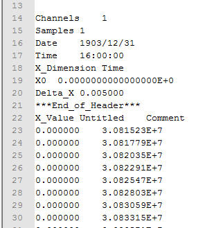

The dt value of the local variable is 0.005.   This delta T is recorded in the saved file, but the timestamps do not change from the initial value of o,o:

so you create a waveform (in a funny way) with t0 always being zero - and you wonder about zeros in your file?

Express VIs and the Dynamic Datatype can be very limiting in these cases.
Effectively, you are writing single point waveforms with the same t0 which results in them all displaying t0 as 0.
You might consider using Write to Delimited File instead.
Or you can construct your waveforms so that they log the right t0.
I generally avoid using Express VIs and the Dynamic Datatype but I think that's where your issue lies.
Unpacking your scalar to dynamic data and then repacking it into a single element array to pack into a waveform is more manipulation than necessary and you should probably just skip that part.

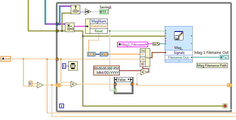

I took your suggestion and reworked the code to write a single-point waveform with the correct t0.  In the diagram below, the t0 increased by dt for each element dequeued.  The code is inefficient because I'm writing one point at a time, but I get the desired result:
A 1-D array of size one is built for each element dequeued.   Are you suggesting that if I instead built an array of length >1, then t0 would be a constant and the timestamp would increase by dt?

As far as I know and using the screenshot you put before, if you want to avoid to reset the t0 I believe you should double check what do you have in the true case, because it sounds like you have a constant of 0.
Regards
