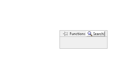

I've an issue now with creating VIs in Target Part which is : when I'm trying to add any function from Functions Palette, I find no functions in it ! as in the image.functions.png
Is there anything missing or i have to install?

I would recommend looking at this KB: http://digital.ni.com/public.nsf/allkb/AE0B46020D22C7E4862565550071FB1D. I would also try using Quick Drop (ctrl + Spacebar) to see if you can select any functions. If so, that would suggest the files do still exist.
