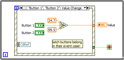

  • Don't use mouse action on booleans, do a "value changed" event.
  • Latch action booleans belong inside their event case so they can properly reset.
  • Yes, check the control reference from the event data node.
Attached is a very simple example how it could be done (the timeout case just resets the indicators after 400ms).
Still, if there are only two buttons, just use the value (since the event can only fire for one of the two, checking one is sufficient. And since the buttons are latch action, the pressed button will be TRUE, guaranteed!)

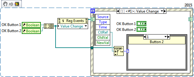

Here's another way to do it that's more complicated but scales to any amount of buttons:
It does not really scale well if you have to create "any amount of control references". Starts getting tedious. 🙂

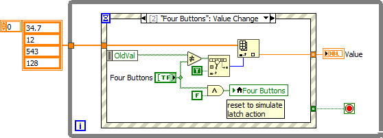

Full scalability can be achieved by using arrays of buttons, e.g. as follows. Now the code would not look any different with 20 buttons. 😄 Latch action can be achieved by resetting. (For more artistic freedom (buttons with different labels/colors etc.), a cluster of booleans could be used, the result of the "not requal"  to be turned into an array for detection in a similar way).
