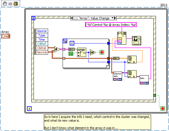

The problem I'm currently stuck on is fairly simple to understand if you can afford to ttake a look at the VI im attaching.
I have an array in my UI whose element type is a cluster of several controls.  On the UI of my actual app (and also the example vi I made) There is more than one element shown at a time in the array.  The array size is fixed, there are 8 elements visible whose individual controls are changed by the user.
I figured out how to get the name of the control I've changed the value of inside the element, but I don't know what element it was changed in.  I was hoping the solution could be easier than dealing with the coordinates of what element was changed... I'm aiming for scalability here.  Do any of you labviewers know of a prop node or somehting that will give me an indication of what elem changed?

I was going to whine that the answer can be found with search, but I can't find it in search!
One way is to keep the array value in a shift register and compare the previous values with the current values.

Can you guys take a look at this picture and tell me why this isnt working?  maybe it something real stupid im missing here, but based on what the probes are reporting shouldnt this work?!?!

Here's a different (and working) approach.  No need for the complicated dynamic event registration.  See image below.
The Variant functions (GetClusterInfo and GetTypeInfo) are from vi.lib\utility\VariantDataType.
It is working, it just isn't doing what you want.  You're getting the index of the element within the cluster that changed, whereas what you wanted was the index of the array element that changed.
