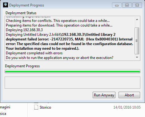

Moreover, I don't know why I get this error at Host application startup (in both cases A & B) BUT when I press Run Anyway the software works...anyway.

Hi Dindex,
I found a document that explains the error and how to solve.
Speaking about the first point, so the VI that is stopped after one day of execution on the second target, does it give you any kind of error?

Hi Monchi,
I had already read that document but its not my case, it is obvious that Network variable engine is installed.
I've found a workaround, anyway. Instead of using shared variables, now using shared variable nodes (programmatic access) it gives to me no errors. It's strange, isn't it?
