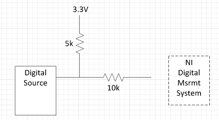

I have a digital instrument with the setup that is shown below.  I wish to measure the logic state of the line with a National Instruments device.  Which one do you recommend?
Trials and Failures: I tried using the usb-6501 but because of the 5V and 5k ohm pull-up on the insides of this device, I was getting bad readings and was told by my peers that this was the wrong instrument to use.  I also tried using the digital pins on the usb-8451 and received the incorrect measurements. I need to figure out why the usb-8451 seemed to have the input pins floating when the logic level I provided as an input was a LOW.
The figure below is a representation of my signal source:

Because NI (and many other manufacturers) like to have pull up or pull down resistors in their intruments, I would recommend adding a digital buffer chip between your circuit and the NI DIO.  That will provide some isolation between the circuit and the DIO's bias resistors.

Thank you for the response.  Since my DUT is already assembled, it is a little late to add chips.  However, a coworker suggested adding a 0 ohm jumper on top fo the 10k resistor.  I will see if this works and provide an update.

Measure it with an analog input?
I was recommending adding the chip to your test circuitry, not the DUT.

We purchased a couple of USB-6001 that have 13 DIO, 8AI, and 2AO and I will be connecting these to the lines to see if they are able to detect the correct LOW and HIGH voltages.  My guess is that because of the high-input impedance of the analog inputs (>1G Ohm), this will surely work.
I will come back and post an update once I have tested this.
Thank you all for your time.
