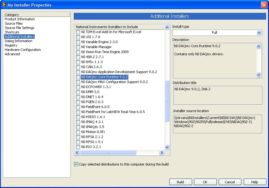

Hi CFiset,
Unfortunately, there isn't a way to remove the .NET installation with your current version of the DAQmx driver (8.9.5). If you update your driver to DAQmx 9.0 or higher, you will have the option to include just the core drivers or the full development support. If you select to just install the DAQmx Core Run-time and/or the DAQmx MAX Configuration Support, .NET will not be installed on the target computers.

This work for me
Thank
