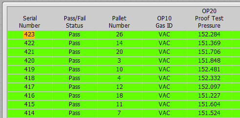

You can embed your picture into the posts so it is easier for all of use to understand the problem.
Listbox
It also helps to give more context. Is your listbox a control or indicator and how does the user interact with it? As has been said, you can set the selection color to the cell color.
If this is just a glorified table listing tests results, maybe a table indicator would be more suitable. In a table, the 2D array of strings is the "value". For a listbox, the selected item(s) is the "value" and it should typically be highlighted so we actually know the value!
