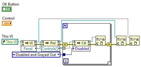

I like to use it wrapped inside a subVI, but you can of course have it in the BD of the main VI, have a look at this example:
Message 2 of 12
(7,862 Views)

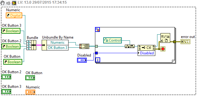

So you have to create references of your front panel controls, this can be quick, since you can select multiple, and with right click you create references.
I have attached a version LV2010.
edit: another advice:
You have to create only once these references. Usually it is comfortable to bundle all the references into a cluster, and use this wire through your whole code. In this way you can just unbundle those references which at the actual location you need to play with, put them into an array, and use the above FOR loop to change their properties...
Like this:
Message 4 of 12

Ive tried your solution, still takes up a bit of space but is much cleaner than using a bunch of property nodes. Thank you Blokk!

Apok,
I like your solution bc I'm not a fan of disabling each control individually, but my only question is lets say I have 20 controls, but only want to disable 15 of those 20, is that possible with your setup?
Message 8 of 12
(7,781 Views)
No, Apok's solution will act on ALL controls. Use my solution for selective manipulation. I mean the solution with Bundle to cluster and Unbundle by name + build array...
And use a subVI to save space on your BD!
See attachment...
Message 9 of 12
(7,773 Views)
ups, I forgot to add the usual Error case as it should have like other subVIs, see the revised version.
