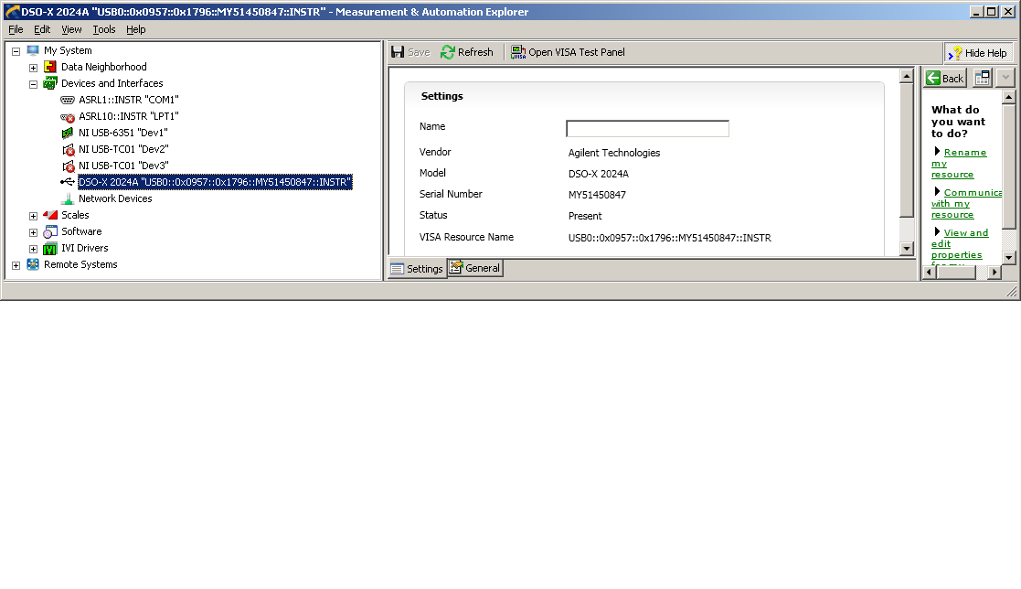

@prof.Anil wrote:
Is that common problem ?
Well, technically YES.  A timeout error is a very general problem that means you're not communication with the scope.  There could be many reasons why.  The firs thing to do is see if your scope shows up in NI MAX (Measurement and Automation Explorer).  Click on Devices and Interfaces and tell us if you see your DSO.  If NOT, you must fix the problem before you go any further...

Yes ı see.
